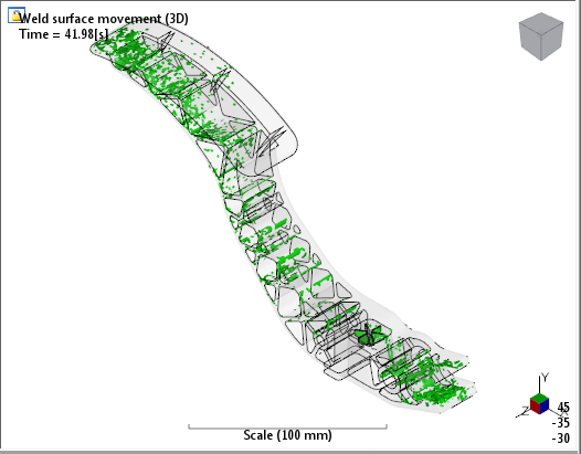

The pedal arm contains weld surface data from Moldflow. In order to understand the effect the weld surfaces have on the structural life of the pedal arm, we must first calculate the strength reduction factor for each point that lies on the weld surface.
