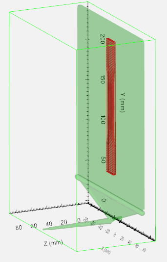

Align Models
Please enable Javascript to watch this video.
Click
Yes
when prompted to use the interactive alignment tool.
Enter
20
mm for
TY
and
-38.1
mm for
TZ
and click
Apply
Use your mouse to rotate the model and make sure the two parts are aligned properly. Click
OK
