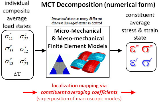

The picture below shows a schematic diagram of the numerical decomposition method which relies on high fidelity finite element models of the composite material's meso-structure and micro-structure. For example, for a plain weave composite, the numerical method would require the use of a meso-scale finite element model of the woven composite that used a homogenized material description of the warp tows, fill tows and matrix pockets, i.e., a finite element model with three meso-constituents. Individual homogeneous macroscopic stress states can be imposed on the meso-scale finite element model, and the resulting solution can be used to compute the average stress and strain states in the homogenized warp tows, homogenized fill tows, and pure matrix pockets. These meso-scale finite element solutions can be used to compute sets of influence coefficients that directly map macroscopic stress and strain components into meso-constituent average stress and strain states for the warp tows, fill tows, and matrix pockets. A set of these meso-constituent influence coefficients are determined for each discrete damage state that can be exhibited by the woven composite material. The resulting coefficients are stored in a material database for immediate access during a structural-level progressive failure simulation. Finally, the average stress and strain states in the homogenized warp tows and fill tows can be decomposed into fiber and matrix average stress and strain states using the analytical binary decomposition.
