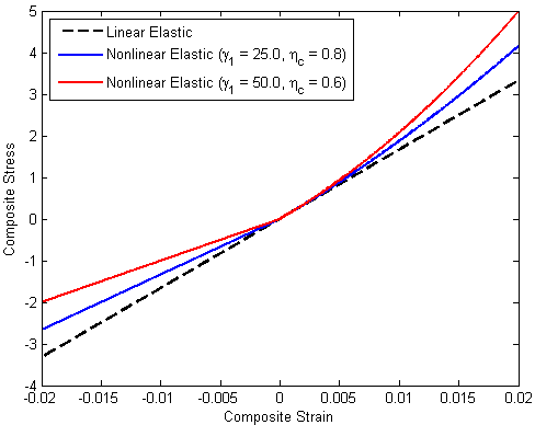

Two options exist for modifying the fiber modulus in compression to model softening behavior. You can use Eq. 28 with a different nonlinear parameter (). Alternatively, a composite modulus knock down factor, ηc, can be used to simulate the softening behavior as described in Eq. 30.
where is the original composite modulus. All other fiber and composite elastic constants retain their original values.
Eq. 31 is a limit on the value of the compressive nonlinear parameter () which prevents the modulus from going to zero before the failure has occurred.
where C1 is the absolute value of the longitudinal compressive strength.

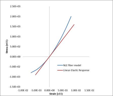

The plot below compares the composite level stress-strain behavior of a material under pure axial loading with different nonlinear parameters ( and ηc). The black dashed line represents the linear elastic response used if the nonlinear elastic fiber model is not enabled.
The plot below shows a comparison between the longitudinal stress-strain response using the model given in Eq. 28 for compression and tension.
