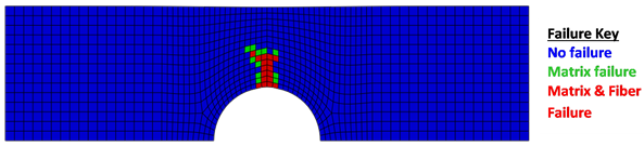

The image below shows a [0°/ ±45°]s unidirectional composite plate that was analyzed using the progressive failure feature with both pre-failure and post-failure nonlinearity turned off. It shows a contour plot of the MCT state variable SVAR1, representing the composite damage state in the 0° plies. The blue areas represent composite material with unfailed constituents (SVAR1=1). The green areas represent composite material with a failed matrix constituent (SVAR1=2). The red areas represent composite material with matrix and fiber constituents that have failed (SVAR1=3).
