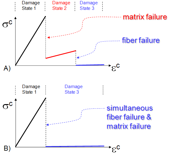

History 1: Damage State 1 → Damage State 2 → Damage State 3
History 2: Damage State 1 → Damage State 3
The image below illustrates the qualitative nature of these two histories. Regarding the overall responses of the composite material shown below, several issues are worthy of further discussion. First, for each of the composite material's three distinct damage states, the stiffness and thermal properties of the composite material (Cc and αc) are obtained by homogenization of the microstructure containing constituent materials that each have a status of failed or unfailed. For a failed matrix constituent in the microstructure, the matrix constituent's stiffness is isotropically reduced to a user-specified percentage (default=10%) of the original matrix stiffnessCIR. The reduced matrix stiffness directly affects the stiffness of the composite material via the homogenization process. For a failed fiber constituent in the microstructure, the fiber constituent's stiffness is isotropically reduced to a user-specified percentage (default=1%) of the original matrix stiffnessCIR. The reduced fiber stiffness directly affects the stiffness of the composite material via the homogenization process.
Second, a separate MCT decomposition must be formulated for each of the three composite damage states shown below. Recall that the MCT decomposition requires the use of linear constitutive relations where the individual components of Cc, Cf, Cm, αc, αf, and αm are simply constants. Generally speaking, these constants differ from one linear segment of the response to the next, thus the MCT decomposition is different in each section. By limiting the overall response of the composite to three distinct damage states, the process of determining the MCT decomposition constants needed for each segment of the response can be performed once. The resulting constants are stored in a database. Then, depending upon the discrete damage state of the composite, the appropriate set of MCT decomposition constants can simply be retrieved from the database. This feature contributes significantly to the overall computational efficiency of Helius PFA.
