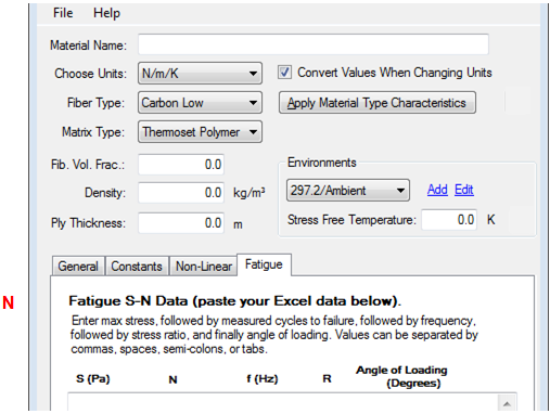

If the material being created is to be used in a fatigue analysis, fatigue data must be entered in the Fatigue tab.
N - Fatigue Data
This field contains experimental lamina fatigue data which are S-N data points. An S-N data point contains the following information:
This data is used to optimize material fatigue constants used in a Helius PFA fatigue analysis.

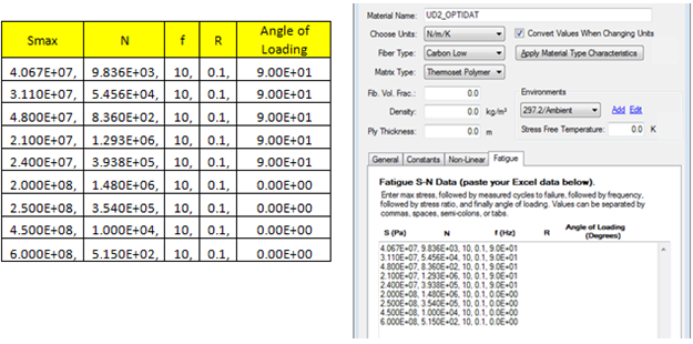

At least two data points at a 0-2o load angle and two data points at a 2-90o load angle are required to perform the optimization.
Suppose the data below is provided as experimentally measured fatigue data. The data would be entered into the GUI as shown below.
