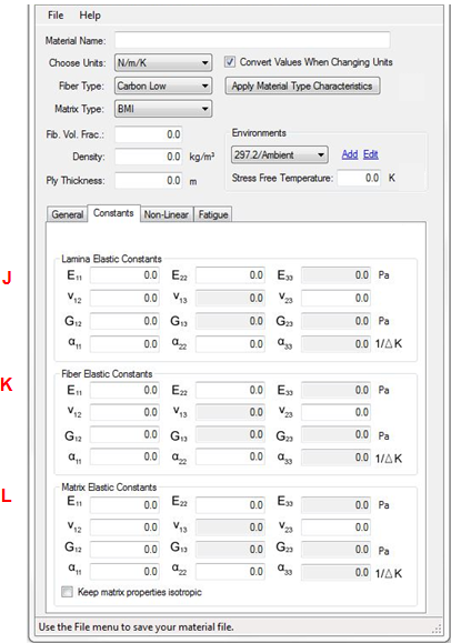

Unidirectional Constants Tab
Specify the elastic constants and thermal coefficients for the lamina.
The following fields must be specified under the Constants tab (fields J, K, and L).
J - Lamina Elastic Constants (required)
These are the standard lamina material properties. Helius PFA treats the lamina as transversely isotropic.
K - Fiber Elastic Constants (required)
Helius PFA treats the fiber constituent properties as transversely isotropic. If these constituent properties are not known, Autodesk has provided default constituent properties that can be entered by selecting a fiber under the fiber type drop-down menu and then clicking on "Apply Material Type Characteristics". The fiber type provides a starting point for constituent properties which will be modified when the mdata file is saved to correlate with the lamina properties you specify. Currently, default properties are only provided for carbon, glass, and Kevlar fibers. If you have a different material system, please contact Autodesk to complete a material characterization. If a thermal analysis is desired, the coefficients of thermal expansion must be entered. If the coefficients of thermal expansion of the composite are left at zero, the fiber thermal expansion must also be set to zero. A description of the origin of the default material properties is provided in Appendix A.
L - Matrix Elastic Constants (required)
