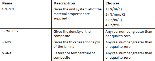

*MATERIAL
At least one *MATERIAL keyword must be present. This keyword defines a new material to be solved for.
*MATERIAL

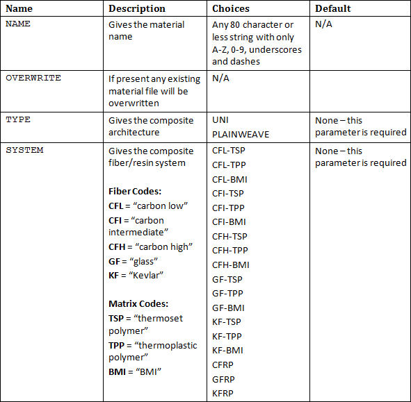

UNITS, DENSITY, PLYT, TREF
Parameters
Note: The standard CFRP, GFRP, and KFRP composite systems are still supported parameters with the *MATERIAL keyword. To specify a specific fiber or matrix system, use the appropriate combination of fiber and matrix codes listed above. The specific fiber and matrix codes (i.e. CFL-TSP) are only supported for versions 2015.1 and later.

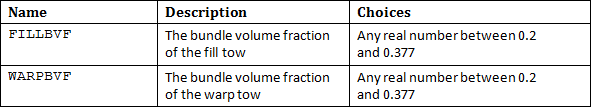

*BVF
The *BVF keyword is a child of *MATERIAL and must be present for plain weave materials (Note: satin fabric materials are not supported in batch mode). This keyword supplies the bundle volume fraction information.
*BVF
FILLBVF, WARPBVF
Parameters
NONE
Data

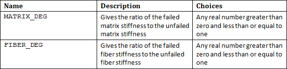

*DEGRADATION
The *DEGRADATION keyword is a child of *MATERIAL and must be present for plain weave materials. This keyword supplies the ratios of failed stiffness to virgin stiffness of the matrix and fiber constituents.
*DEGRADATION
MATRIX_DEG, FIBER_DEG
Parameters
NONE
Data

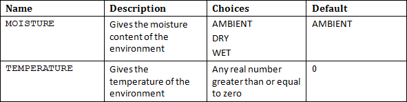

*ENVIRONMENT
The *ENVIRONMENT keyword is a child of *MATERIAL. At least one *ENVIRONMENT keyword must be specified for each *MATERIAL. This keyword begins the definition of an environment containing a set of material properties for the current material.
*ENVIRONMENT, MOISTURE=AMBIENT/DRY/WET, TEMPERATURE=TEMP
Parameters
Data
NONE

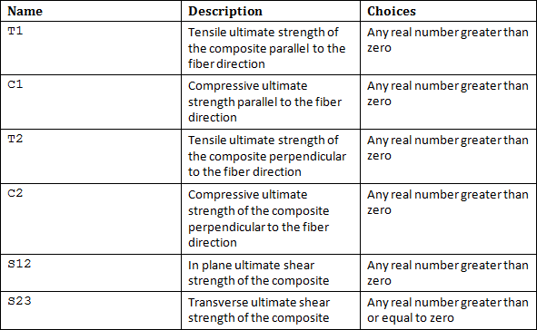

*STRENGTHS
The *STRENGTHS keyword is a child of *ENVIRONMENT. For unidirectional composites the *STRENGTHS keyword data is:
*STRENGTHS
T1, C1, T2, C2, S12, S23
Parameters
NONE
Data

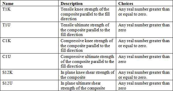

For plain weave composites the *STRENGTHS keyword data is:
*STRENGTHS
T1K, T1U, C1K, C1U, S12K, S12U
Parameters
NONE
Data

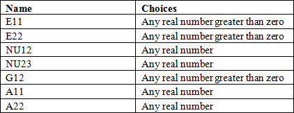

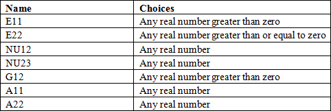

*LAMINA
The *LAMINA keyword is a child of *ENVIRONMENT and is required. This keyword gives the target elastic constants of the lamina. For unidirectional composites the material is assumed to be transversely isotropic with respect to the 2-3 plane. The data for *LAMINA for a unidirectional composite is:
*LAMINA
E11, E22, NU12, NU23, G12, A11, A33

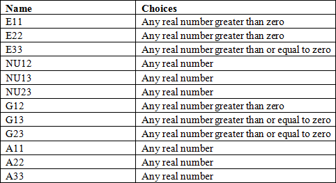

For plain weave composites the material is assumed to be orthotropic. If all material properties are known they can be supplied. Otherwise, the following properties can be supplied as zero and will be calculated by CMM: E33, NU13, NU23, G13, G23, and A33. The data for *LAMINA for a plain weave composite is:
*LAMINA
E11, E22, E33, NU12, NU13, NU23, G12, G13, G23, A11, A22, A33
Parameters
NONE
Data

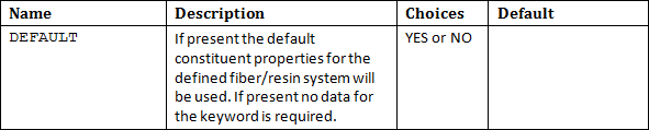

*FIBER
The *FIBER keyword is a child of *ENVIRONMENT and is required. This keyword gives the starting elastic constants of the fiber constituent. The fiber is assumed to be transversely isotropic with respect to the 2-3 plane.
*FIBER, [DEFAULT]
Parameters
Data

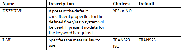

*MATRIX
The *MATRIX keyword is a child of *ENVIRONMENT and is required. This keyword gives the starting elastic constants of the matrix constituent.
*MATRIX, [DEFAULT], [LAW=TRANS23/ISO]
If LAW=ISO the data for the *MATRIX keyword is:
*MATRIX, LAW=ISO
E, NU, A
Parameters
Data

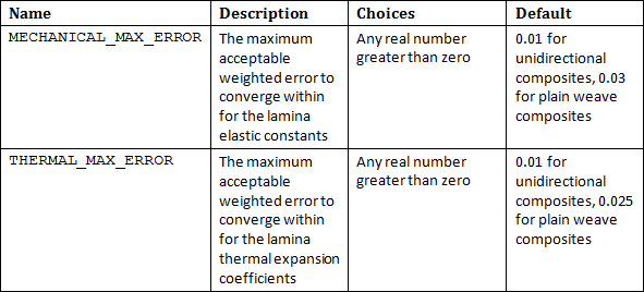

*SOLVE
One (and only one) *SOLVE keyword must be present. This keyword gives the settings for the solving and output process.
*SOLVE, MATDIR=MATDIR
MECHANICAL_MAX_ERROR, THERMAL_MAX_ERROR
Parameters
Data
