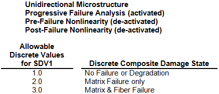

The fundamental MCT state variable is SDV1 which indicates the discrete damage state of the composite material. SDV1 is a real variable that can assume a finite number of discrete values between 1.0 ≤ SDV1 < 4.0. The specific set of discrete values that can be assumed by SDV1 depends upon the type of composite material (unidirectional or woven) and the specific set of material nonlinearity features used by Helius PFA during the finite element solution (see Appendix C). An MCT file (*.mct) is generated when an analysis enhanced with Helius PFA is submitted and contains the specific set of values that can be assumed by SDV1 for each material in the model.

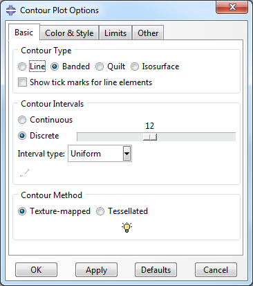

Because SDV1 is a discrete real variable taking values 1.0 ≤ SDV1 < 4.0, it is important to change the settings of Abaqus/Viewer so that a unique color contour is associated with each discrete integer value of SDV1. In the case where SDV1 can assume values of 1.0, 2.0, or 3.0, set the number of color contours to 3. The number of contour intervals used in a contour plot can be specified from the Contour Plot Options dialog box, which is accessed by clicking Options > Contour from the main toolbar. The Contour Plot Options dialog box is shown below. Under the heading 'Contour Intervals', choose 'Discrete' and use the slider bar to select the number of discrete color contours to match the number of integer values SDV1 can assume.

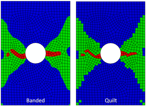

The image below shows two different contour plots of the integer variable SDV1 for an axially loaded composite plate with a central hole. The use of three discrete colors makes it easy to identify the regions where each discrete composite damage state occurs. The blue elements (SDV1=1) are completely undamaged; the green elements (SDV1=2) have failed matrix constituents and undamaged fibers; the red elements (SDV1=3) have failed matrix constituents and failed fiber constituents. Note that the quilt contour plot shows the average value of SDV1 for each individual element, while the banded contour plot simply uses the values of SDV1 at the individual integration points to establish the color contours independent of the element boundaries.

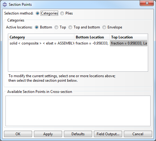

When viewing finite element solution results for laminated composite structures, you must be aware of the numbering of section points through the thickness of multilayer elements. A contour plot will only use the values of the variable stored at a particular section point. Therefore, to view a contour plot for a specific material layer, you must choose a section point that lies within that material layer. To choose a specific section point, access the Section Points dialog box by selecting Results > Section Points from the main toolbar. The Section Points dialog box is shown below. The default section point plotted by Abaqus/Viewer is the bottom section point (i.e., the section point at the bottom of the element). To view results for a particular material ply, check the Plies option and select the appropriate ply. Select the Envelope option to view results for all section points in the same plot. Envelope plots show the maximum absolute, maximum, or minimum value of the selected variable across all of the plies in a layup.

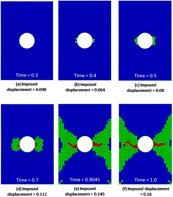

As an example of the recommendations above, consider the image below. This shows envelope quilted contour plots of SDV1=1,2,3 at several points in time during a progressive failure analysis of a composite plate with a central hole. The plate has eight material plies and is loaded in tension. Since these contour plots are envelope plots, the color at any location represents the highest value of SDV1 achieved at any of the section points distributed through the thickness of the 8-ply laminate. In these plots, blue elements have no failure at any of the section points distributed through the laminate thickness. The green elements have at least one section point where matrix failure has occurred, while the red elements have at least one section point where both matrix and fiber failure occurred.
Several important observations can be made regarding the sequence of envelope quilted contour plots shown above:
