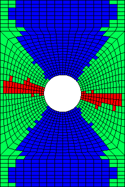

The image below shows an assignment type fringe plot of PFA Damage State for an axially loaded composite plate with a central hole. The use of three discrete colors makes it easy to identify the regions where each discrete composite damage state occurs. The blue elements (PFA Damage State = 1) are undamaged, the green elements (PFA Damage State = 2) have failed matrix constituents and undamaged fibers, and the red elements (PFA Damage State = 3) have failed matrix and fiber constituents.

As an example of the recommendations above, consider the image below. This shows contour plots of PFA Damage State = 1,2,3 at several points in time during a progressive failure analysis of a composite plate with a central hole. The plate has eight material plies and is loaded in tension. Since there are multiple plies, we must make sure to evaluate PFA Damage State in each ply. In these plots, blue elements have no failure at any of the integration points in the given ply. The green elements have at least one integration point where matrix failure has occurred, while the red elements have at least one integration point where both matrix and fiber failure occurred.
