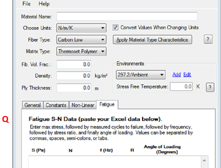

If the woven material being created is to be used in a fatigue analysis, fatigue data must be entered in the Fatigue tab.
Q - Fatigue Data

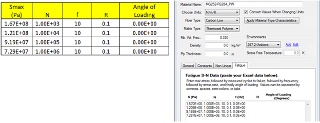

This field contains experimental lamina fatigue data which are S-N data points. An S-N data point contains the following information:
This data is used to optimize material fatigue constants used in a Helius PFA fatigue analysis. At least two data points are required to perform the optimization.
Suppose the data below is provided as experimentally measured fatigue data. This data would be entered into the GUI as shown below:
