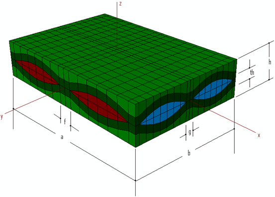

The plain woven composite micromechanics model consists of fill tows, warp tows, and a matrix pocket. The fill and warp tows are assumed to be perpendicular to each other. The unit cell chosen to model this type of microstructure was taken from Kuhn and Charalambides [1], and is shown below.
As seen above, there are many parameters required to completely describe the geometry of the unit cell. These include:
  1. The length of the unit cell
  2. The width of the unit cell
  3. The height of the total unit cell
  4. The height of the fill tows
  5. The height of the warp tows
  6. The spacing between the fill tows
  7. The spacing between the warp tows

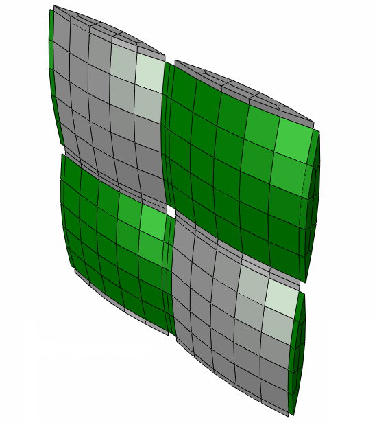

A view of the unit cell without the matrix pocket is shown below.

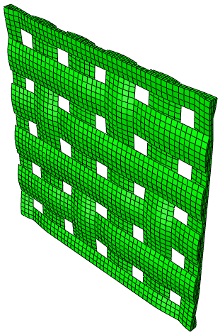

Full Unit Cell Microstructure (Satin Weaves)
The Full Unit Cell (FUC) microstructure for satin weave materials is similar to the plain weave model in that it consists of fill tows, warp tows, and a matrix pocket. The FUC also assumes the fill and warp tows are perpendicular to one another. As with the plain weave microstructure, there are many geometric properties required to define the FUC microstructure (length, width, height, spacing).

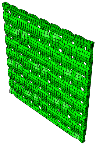

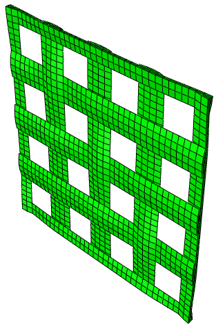

The FUC microstructure begins to differ from the plain weave model when the harness number is considered. The unit cell begins to grow as we progress from 4 to 5 to 8-harness materials. New tows are added to the microstructure to capture the undulations respective of each satin type. The images below depict the microstructure for each n-harness material (shown without the matrix pocket for various bundle volume fractions). Notice how the size of the unit cell increases as the harness number increases.
4-Harness
5-Harness
8-Harness

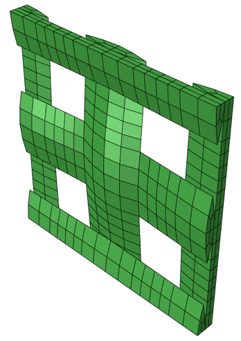

Reduced Unit Cell Microstructure (Satin Weaves)
The Reduced Unit Cell (RUC) microstructure for satin weave materials is an adaptation of the Full Unit Cell microstructure. The RUC is simply a subset of the repeating geometry found in the FUC. Rather than adjusting the microstructure for each n-harness material, the RUC maintains a constant size and topology. Only the amplitude of the curvature of the two center tows are adjusted as the harness number changes.
Specifically, the amplitude is adjusted to allow the average in-plane stiffnesses (E11, E22, G12) to match experimentally observed values for each harness number.
The RUC microstructure has the distinct advantage that it is smaller than the FUC and therefore, much faster to characterize. As a result, the RUC microstructure supports on-the-fly degradation of fiber and matrix stiffnesses. It also supports pre-failure nonlinearity, which is not supported for the FUC.

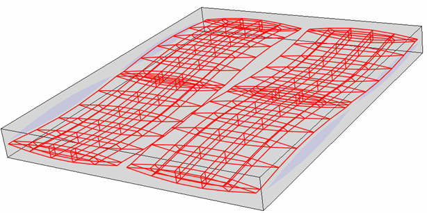

where BVFFill is the fill bundle volume fraction, BVFWarp is the warp bundle volume fraction, FVFFill is the fiber volume fraction of the fill tow, and FVFWarp is the fiber volume fraction of the warp tow. A bundle volume fraction is defined as the fraction of the volume the specified tow occupies compared to the entire composite. To present a more detailed discussion on bundle volume fractions and their meaning in the context of the geometry of the plain weave unit cell, consider the image below. The red highlighted region represents the volume the fill tows occupy in the entire composite unit cell. The fill bundle volume fraction is calculated as the volume of the fill tows divided by the volume of the composite.

Finally, we assume the widths of the tows are equal and constant. Therefore, the width and length of the unit cell may be related to the spacing of the tows as:
a = width + 2f
b = width + 2g , (Eq. 2)
Therefore, only two unknown parameters are needed to completely describe the geometry of the unit cell; the spacing between the fill tows and the spacing between the warp tows. These parameters are directly related to the volume fractions of the fill and warp bundles, and to the number of undulations per unit length. Composite Material Manager uses bundle volume fractions (BVFs) to define the microstructure.
