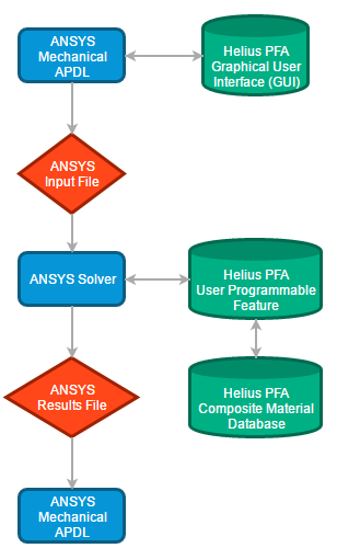

The image below shows a schematic diagram of the individual components of the Helius PFA software and their interaction with the ANSYS software components. Blue rectangles indicate the components of the ANSYS finite element modeling package, red diamonds indicate files containing inputs and outputs, and green ovals indicate the individual components of the software. The Helius PFA Graphical User Interface (GUI) is accessed from within the ANSYS Mechanical APDL and assists you in defining the ANSYS input file commands required during a finite element analysis that uses Helius PFA.
The Helius PFA User Programmable Feature calculates composite constitutive relations and stresses for use within the ANSYS finite element code. It contains all of the MCT constitutive relations for the individual constituent materials (fiber and matrix) and the homogenized composite material. In addition, the User Programmable Feature contains the constituent damage and failure criteria and the algorithms to degrade the stiffnesses of the constituents and the homogenized composite material to reflect the current damaged state of each constituent material. The ANSYS finite element code calls the User Programmable Feature at each Gaussian integration point in the model where constitutive relations or stresses are needed.
In graphic below, the Helius PFA Composite Material Database is used to store all of the material coefficients that are needed to completely define the MCT multiscale material model for various composite materials. Before a particular composite material can be used in a Helius PFA-enhanced finite element model, the composite material must undergo MCT characterization, and its coefficients must be entered into the Composite Material Database. As shown below, the Helius PFA User Programmable Feature opens and reads the Composite Material Database to extract the necessary material coefficients for any composite materials that are used in the finite element model. Note, the material database is not necessary for Helius PFA cohesive materials. Since the number of inputs required to define a cohesive material are much less than a composite, the entire material is defined in the ANSYS input file.
