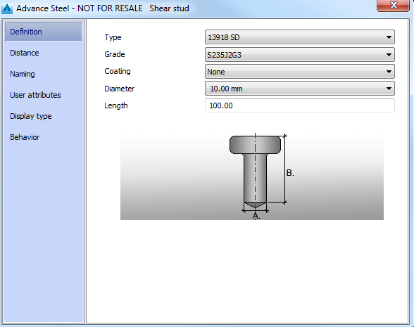

Definition tab
All shear studs have default properties that you can change in the properties dialog box, which automatically opens after you create a shear stud pattern.
Type
Select the stud shear standard from the list.
Grade
Select the steel grade from the list.
Coating
Select the coating from the list.
Diameter
Select the stud shear diameter from the list.
Length
Defines the length of the stud shears.

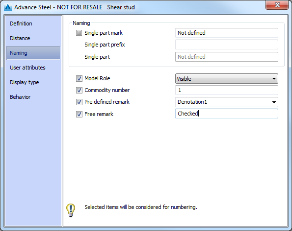

Naming tab
This tab of the properties dialog box allows you to define the information to display in the BOM. Also, it is possible to select the properties to be taken into account at numbering.
Single part mark
Single part prefix
Defines the prefix for the single part mark. You can change the prefix using the Change prefix tool.
Single part counter
Model role
Assigns the role in the model. It is considered e.g. in the drawing creation to assign a presentation, dimensioning and labeling style.
Commodity number
Defines the commodity number of the element.
Predefined remark
Notes concerning the element that you can save in a database and use directly from the Predefined remark drop-down list.
To add a predefined remark, access the AstorBase database located in ProgramData > Autodesk >Advance Steel 2016 > Steel\Data .
Open the Access file and configure your Denotations in the Notes table:
Free remark
Other notes concerning the element.
Note: For a multiple selection of shear studs, changes made for the parameters in the Naming tab are applied to all selected shear studs. This applies to theModel Role, Commodity number,Pre-defined remark and Free remark values and for their corresponding check boxes.

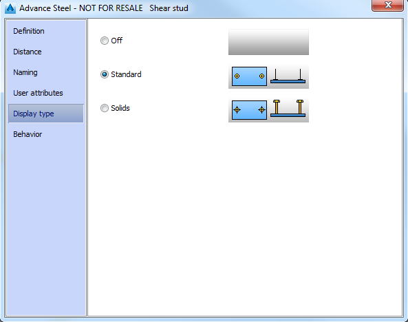

Display type tab
On this tab of the properties dialog box, you can select the stud shear display type.
Display type
Stud shears
Standard
Solids
