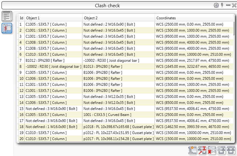

Clash Check dialog box
Displays the list of collisions in beams, plates, and bolts for an entire model or a selection set.
The collisions are numbered with continuous index numbers. For each collision, the involved elements and the coordinates referring to the world coordinate system are listed.
The list of collisions
For each collision found the following information is displayed:

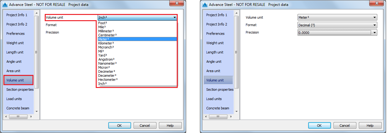

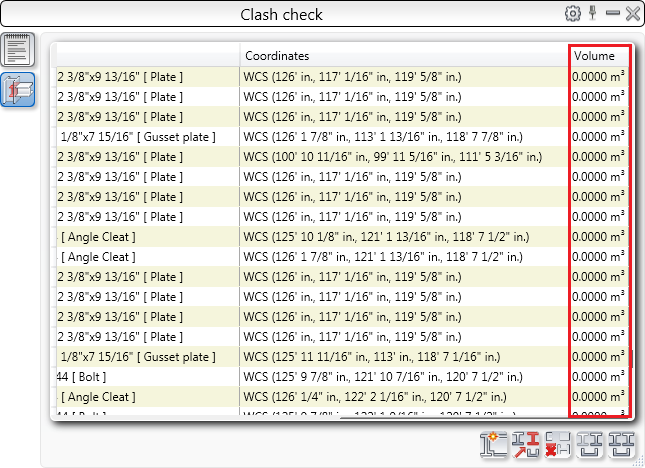

Note:
  • You can configure the volume units the same way you configure other units: Home tab > Settings panel > (Project Settings).
  • In the Project data window, go to Volume units.
The configured volume units will be displayed in the Clash Check results.
Double clicking a line corresponding to a collision zooms directly to the collision solid.
