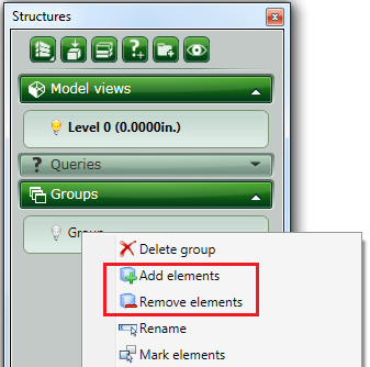

Add elements in a group
  1. In the Project Explorer , right-click the group in which you want to add elements.
  2. Select Add elements from the context menu.
  3. Select the elements to include in the group and press Enter.
Add selected elements in a group
  1. Select the elements to include in the group using any selection method.
  2. In the Project Explorer , right-click the group in which you want to add elements and select Add elements from the context menu.
Remove elements from a group
  1. In the Project Explorer , right-click the group from which you want to remove elements.
  2. Select Remove elements from the context menu.
  3. Select the elements to remove from the group and press <Enter>.
