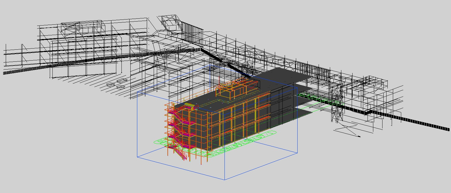

Defines a working space within the model that differentiates the level of detail.
The Work Area increases Advance Steel performance when working with large 3D models. It allows you to define a working space within the model that differentiates the level of detail. Outside the working area, the Advance Steel objects are just displayed with simple graphics. Inside the working area, objects are displayed in full level of detail and you can edit them.
The Work area is defined through the Create Work Area command: on the ribbon,
View
tab >
Work Area
panel > .
Two points are required in the model space to define the diagonal corners of the work area. The level of detail for the objects outside the work area can be defined during creation, or changed using the four buttons available on the ribbon, View tab > Work Area panel:
