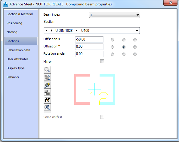

Sections tab
Controls the section class and section size of each individual element in the compound beam, as well as their position.
Note: This tab is only available for compound beams.
Beam index
Lists the indexes of the individual elements in the compound section. The indexes are also displayed in the preview area.
You can select the index of the individual element to modify. The selected section is displayed in red in the preview area.
Section
Allows selecting the individual beam section class, section type and size from the drop-down list displayed by clicking the corresponding arrow .
If the desired section type (or the section size) is not in the list, selecting All displays all available section types (or section sizes) in the database.
Offset on X
Defines the offset along X. The section position is adjusted by the given distance.
Offset on Y
Defines the offset along Y. The section position is adjusted by the given distance.
Rotation angle
Rotates the selected section around its gravity center by the given angle.
Mirror
Flips the selected section about its gravity center.
Same as first
If enabled, the selected section is created with the same properties as the first one.
Preview area
Displays a preview of the compound section. The selected individual section is displayed in red.
