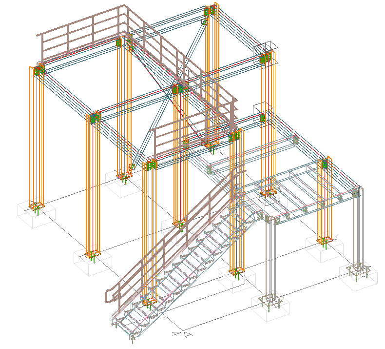

I. Completely check out a connected column
In a shared model, a column is connected to a rafter by a rule based joint.
  1. In the Extended Modeling tab Multi User panel, click (Check out by section - complete).
  2. In the model, select the column and press <Enter>.

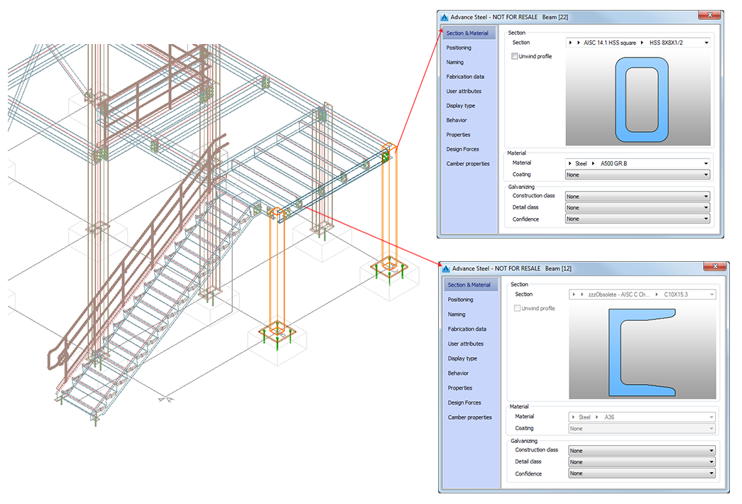

  3. Double-click on the beam that is not checked out, to display its properties. Next, double-click on the column that you checked out to display its properties.
Note that the selected column checked out, along with the rafter that is connected to the column and the elements of the intelligent connections in which the column is involved. The user can modify any of the column properties and the connections. However, only those properties that do not affect the section of the rafter can be changed. The joint can be modified in any way.

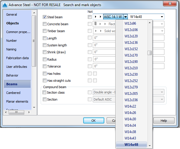

III. Partially check out elements with a W14x48 section
Select all of the beams and columns that have W14x48 sections in the entire model.

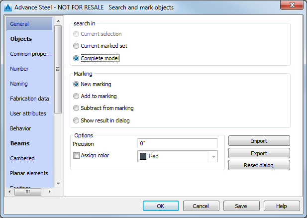

  1. In the Extended Modeling tab Multi User panel, click (Check out by filter - Complete) for a complete check out by filter.
  2. In the Search and mark objects dialog box, define the following settings:
    • In the General tab, select the Complete model search field.
    • In the Beams tab, select the elements that you want to modify (e.g., all of the AISC 14.1 W, W14x48 Steel Beams).

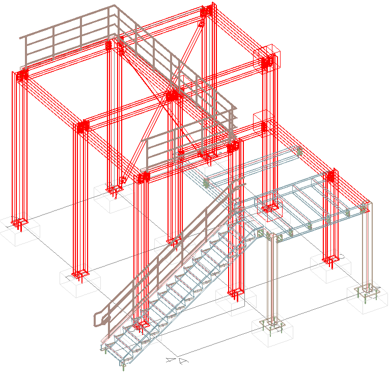

    All the AISC 14.1 W, W14x48 Steel Beams are checked out:
If using the Partial check out tool, only the selected sections are checked out, regardless of their connections. Note that the selected sections are checked out along with the elements that are connected to the searched sections.
