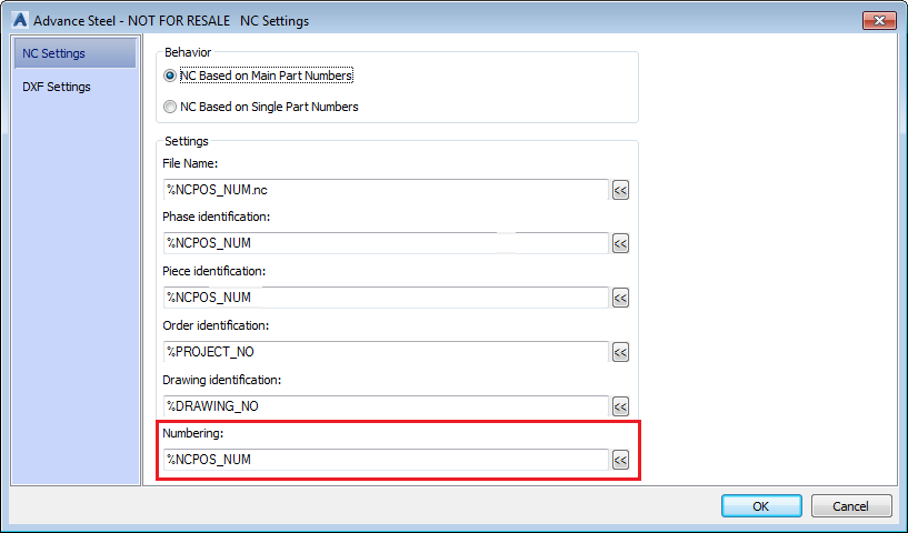

You can use the %NEWLINE token in the NC Setting (Output tab > NC&DXF panel), in the Numbering section to create a configuration line that contains multiple lines. Each line should have at least one token that can evaluate a value (for example %NCPOS_NUM, which displays the object part mark).
Note: All the available usable tokens can be displayed by using the small arrow button on the right side of each field, in the NC Settings dialog.
