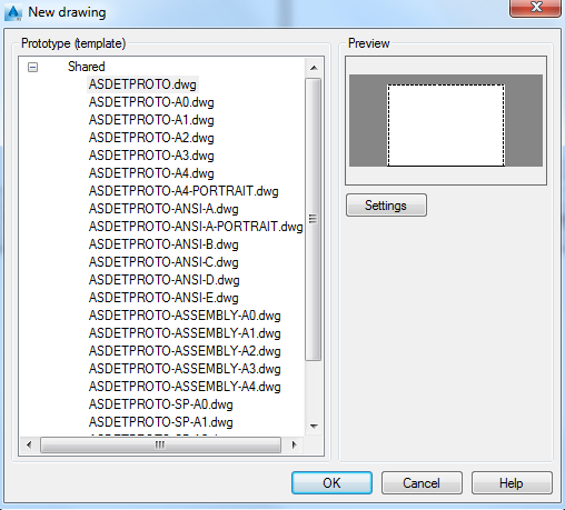

New drawing dialog box
Prototype (template)
The list of the available prototypes.
Preview
Displays a preview of the selected prototype.
Settings
If differences are found between the selected prototype and the current one, this buton displays the Overwrite page settings dialog box.
Select the current settings that should be overwritten:
