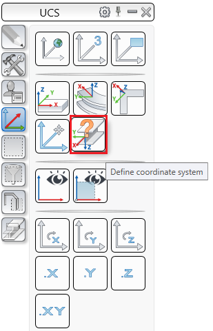

Tip: To distinguish between the start point and the end point of a beam, use the Define coordinate system option on the Advance Steel palette UCS category. The UCS is placed at the start point.
