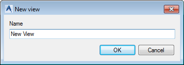

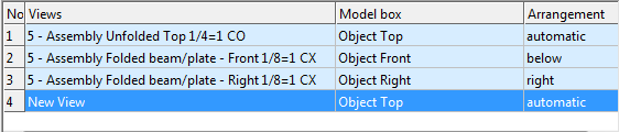

Create a new view
A new view is created by copying a view from the list.
  1. Select a view from the list.
  2. On the properties panel, click (Create a new view).
  3. Enter a name for the new view:
    The new view appears in the tree and in the list.
  4. You can assign a model box and a view arrangement to the new view. This does not affect the original view.

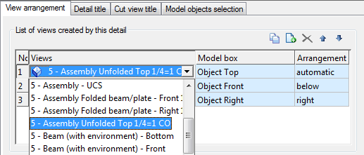

Add an existing view
  1. On the properties panel, click (Add existing view).
  2. Select a view from the tree and click OK. The selected view appears in the tree and in the list. You can assign a model box and a view arrangement to the new view. This does not affect the original view.

Change the order of the views
You can modify the order of views in the list using the two arrow buttons, and .
Note: Changing the order does not affect the drawing creation and is only useful for organizing the list.
