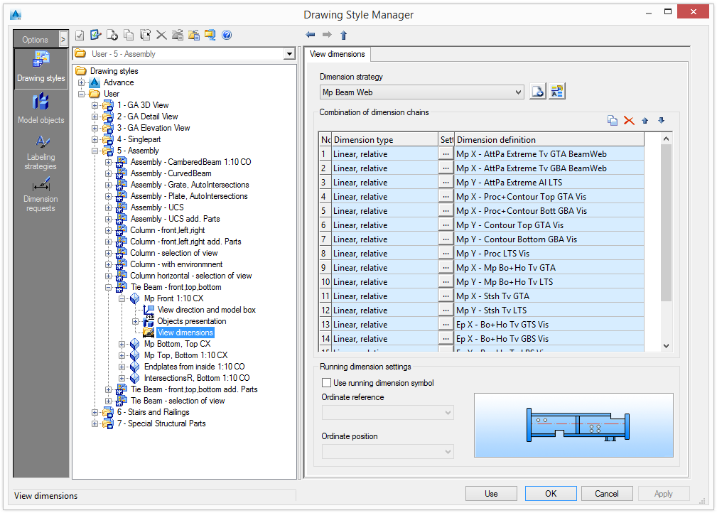

The list of dimension types is on the View dimension tab and can be accessed by two methods:
or
All dimension chains that are created by the selected view are listed in the table. Running dimension settings can be customized along with the settings for the dimension chains.
The properties of each dimension chain definition can be configured in the Dimension request tab.
There are two methods to access it:
or
Attention: All views containing modified dimension chain definitions are also changed.

The "Combination of dimension chains" area displays all the dimensions chains created by the selected view.
A dimension chain is modified directly in the table by selecting the dimension type and the dimension definition from the list.
Only definitions that have been created by Advance in the Dimension request category can be selected. The dimension definition settings are accessible by double-clicking a row in the table. Their properties are configured as described in Dimension Request.
All the views containing the modified dimension chain are also changed.

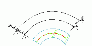

Arc angle, absolute
Arc angle, absolute from end
Arc angle, relative
Arc angle, relative and absolute
Arc angle, relative and absolute from end

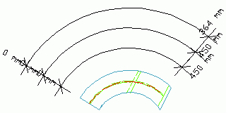

Arc length, absolute
Arc length, absolute from end
Arc length, relative
Arc length, relative and absolute

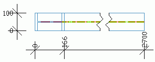

Linear, absolute
Linear, relative
Linear, relative and absolute
Linear, relative and absolute from end

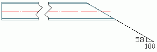

Slope triangle, horizontal
Displays the slope relative to the X direction

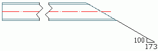

Slope triangle, longest edge
Displays the slope relative to the longest side of the triangle
Slope triangle, smallest edge
Displays the slope relative to the smallest side of the triangle

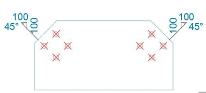

Note: The sloped triangle dimension will always be created towards the outside of the object for symmetrical hole patterns:

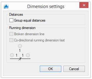

For a linear dimension type, additional settings are made in the Settings column.
  • Click .

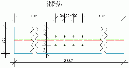

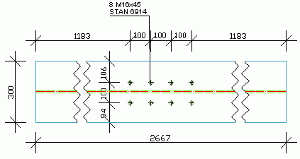

  • Combine equal distances using Group equal distances.
Equal distances not grouped
Equal distances grouped
For a linear absolute dimension type, two more options are available:
  • Broken dimension line - this option is not available for any "relative" dimension type.
  • Co-directional running dimension text - allows setting the position of the dimension text.
