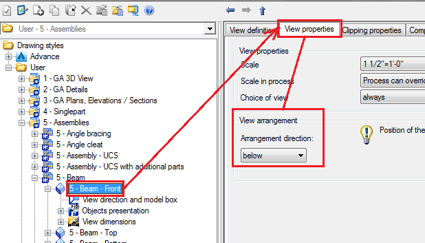

The view arrangement strategies are located in the View properties tab, of the view definition:

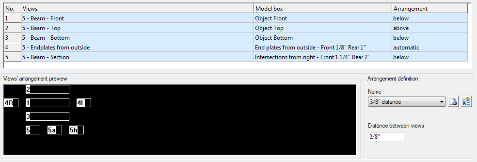

Defining a distance between views (always measured from the extreme object of the detail view) avoids overlapping of individual views on the drawing.
Several predefined distances are available for use.

  1. On the properties panel, click (New).
  2. Enter a name for the new strategy.
  3. Enter the distance between views for this strategy.

  1. Manual settings
    Each view is positioned in relative position to the main view. The options here include below, left and right that are all relative positions to the main view in the paper space.
    For example, in a beam drawing style, the top view can be arranged at the top, but when considering the same beam drawing style for a column with a vertical layout, the same top view will be placed to the left of the main view arranged on the left setting. The schematic preview below the view list determines where each view will be placed in relative position to the main view:

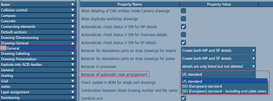

  2. Automatic settings
    This is configured by setting all the views on an automatic arrangement. The automatic layout of the views is done based on the third or first angle rules. The method used here is set by a global default value available in the Management Tools application Defaults category Drawing-General:
