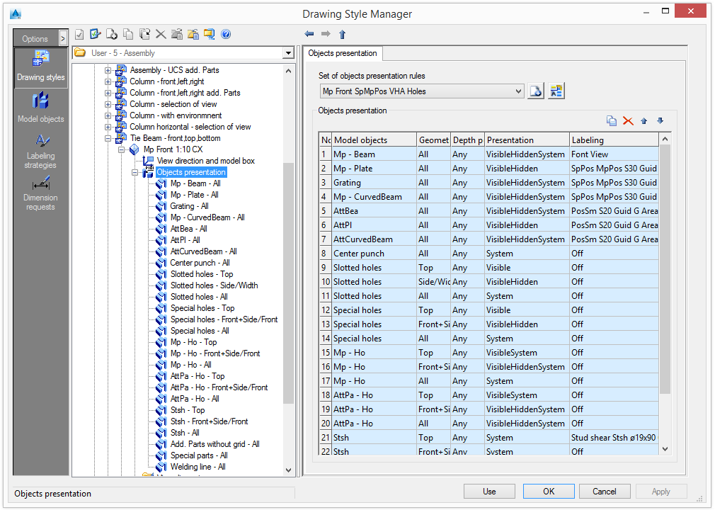

The list of object presentation rules is available on the Objects presentation tab and is accessed by two methods:
or
The model objects are also displayed in the tree panel, under the Objects presentation branch.
Select a set of object presentation rules
Select a predefined set of object presentation rules from the list. The existing rules can be renamed and further definitions can be added.

Modify a set of object presentation rules
Modifications of the object presentation rules are performed using the four buttons on the right side of the "Objects presentation" area. All the views containing the modified set of object presentation rules are also changed.
Button Function
Add a new object presentation rule
Delete an object presentation rule
A new object presentation rule is created using an existing rule.
  1. Select an object presentation rule to use as a template.
  2. Click Add .
The new rule is added to the set of object presentation rules.
  1. Select an object presentation rule to delete.
  2. Click Delete to delete the rule from the list.
Note: The first entry in the table cannot be deleted. To delete an item in the first row of the table, it must be moved down the list.
Change the order of the list
The order of the object presentation rule list is modified with the two arrow buttons, and .
In the assignment of the model object, a certain order must be maintained to achieve the required results. Generally, the list is processed from top to bottom. If a setting can be applied, it will be used. Otherwise, it will move to the next entry.

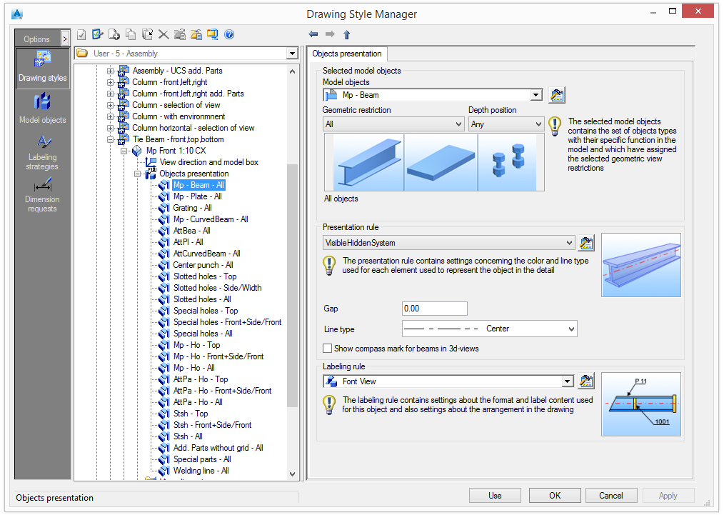

Set the view geometric restrictions for the selected model objects

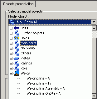

Model objects are selected in the Selected model objects area.
For details about the selected model objects, click (Set). The model objects can be shared by different styles and can be managed separately as described in Model Objects.
The selected model objects define how they are seen in the detail. Two kinds of geometric view restrictions can be defined for each model object:
  • Geometric restriction
  • Depth position
The object presentation name is created by combining the name of the model object, the geometric restriction and the depth position.

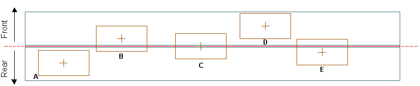

Depth position
The depth position is the "Z" position of the object relative to the main object of the detail. The following options are available:
Depth position Description
Any
On any side of the element
Both sides
On both sides (front and rear) of the main element (plates B, C, E)
Both sides-Center
(plate C)
Both sides-CenterFront
The attached element is on both sides (front and rear) but the center is in the front side of the main part (plate B)
Both sides-CenterRear
The attached element is on both sides (front and rear) but the center is in the rear side of the main part (plate E)
Front (by center)
The center of the attached element is in the front side of the main part (plates B, D)
Front (entirely)
The entire attached element is in the front side of the main part (plate D)
Rear (by center)
The center of the attached element is in the rear side of the main part (plates A, E)
Rear (entirely)
The center of the attached element is on the rear side of the main part (plate A)

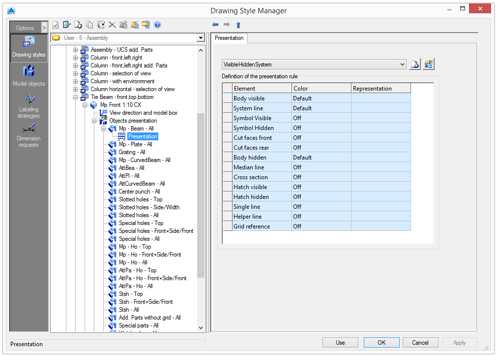

Set the presentation rule
The presentation rule contains settings for color and line type used for each object representation in the detail.
  1. In the Presentation rule area, select a presentation rule from the list.
  2. Click (Set) to view the definition of the selected presentation rule.
Element Representation
Body visible
Visible solid lines
Axis
Only the axes are visible
Symbols
Symbols
Cut faces
Sections plane of solids with model box
Body hidden
Hidden lines
Median line
Median (center) line of the object
Cross section
The cross section of the object
Hatch
The holes are hatched
Simplified line
The beams are shown only with a simplified line
In the case of a simplified line, the line type and the gap are taken into account.
