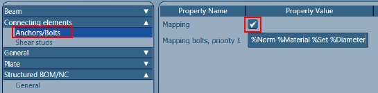

First, turn on the mapping by checking the Mapping default from the Management Tools / Defaults / Connecting elements / Anchors/Bolts.

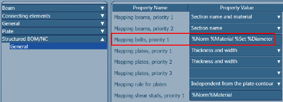

The mapping priority is a series of tokens that form the name of the bolt that takes its mapping from the specific configuration.
This setting is a default value available in the Management Tools / Defaults / Structured BOM/NC category. The default name is Mapping bolts, priority 1.
For example, if you need for each different bolt class, material, set and diameter to get a different mapping, you need to set the default that controls the priority as follows: %Norm %Material %Set %Diameter.

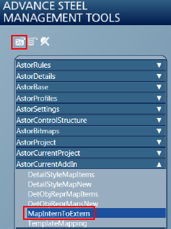

To configure the mapping, open the AstorCurrentAddIn database with the Management Tools Table editor, and then open the table called MapInternToExtern.

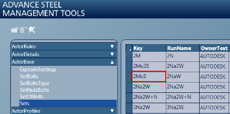

For example, when we refer to the bolt assembly, we need to use the internal name which for a specific bolt assembly can be found as follows: Open the database AstorBase.mdb and go to the Sets table.
The internal name is found in the Key column, while in the RunName column we have the interface name for that specific set. For example the 2NaW set has as internal name 2MuS.

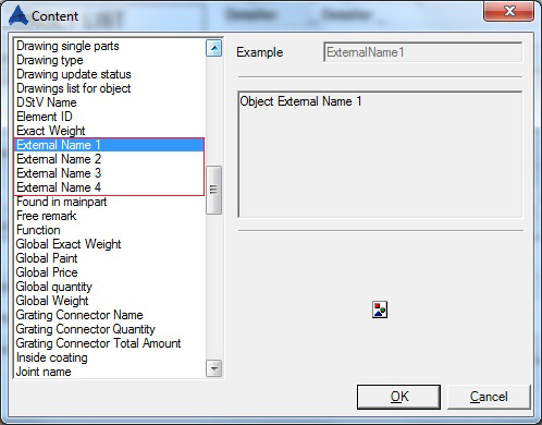

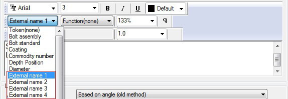

The mapped information from the External1 - 4 columns can be displayed in BOM templates and drawing (labels, detail names) through a series of contents / tokens named External 1 - 4 and they evaluate the respective column information if the object they are attached to corresponds to the mapping priority and value preset in the "Internal" column.
BOM template contents:
Drawing style label editor:
