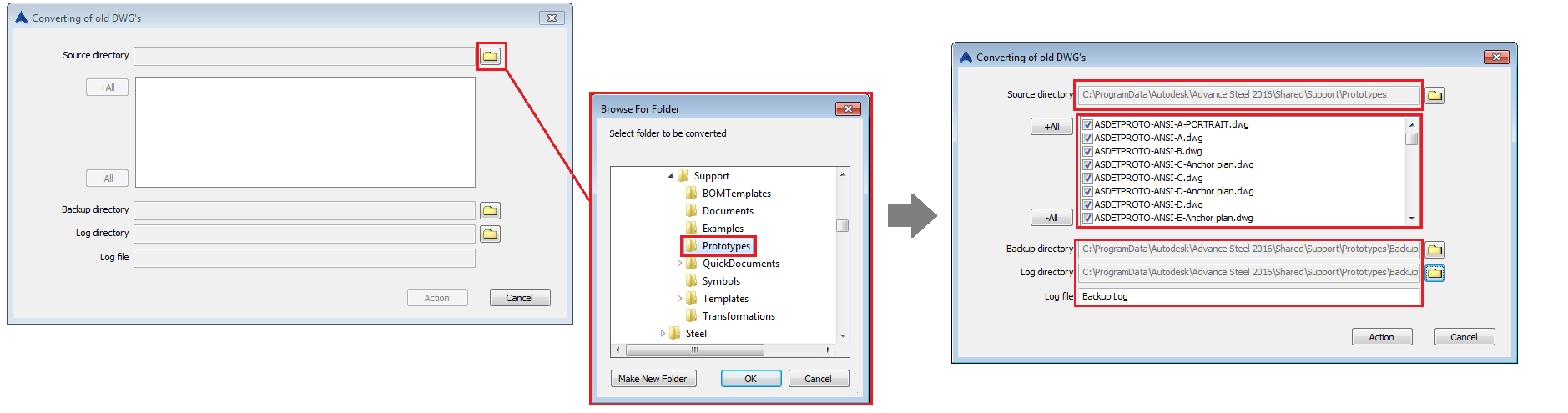

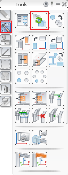

  1. Open the Advance Steel Tool palette.
  2. On the Tools tab, click the (Convert project) tool.
  3. The Converting of old DWG's dialog opens.
  4. Choose a source directory (e.g. C:\ProgramData\Autodesk\Advance Steel 2016\Shared\Support\Prototypes), containing the files you want to convert.
  5. Enter a Backup and Log directory location and name your Log file:
  6. The files are converted for the new version of Advance Steel, replacing the old files in the source directory. The old files are saved in the backup directory chosen at step 5.

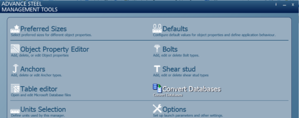

  1. Open Management Tools: Home Settings (Management Tools)
  2. Select Convert database.
  3. Click Open database and select the old version of the database (for example the AstorBase.mdb, located in Program Data folder at the following relative path …\Advance Steel\2016\Steel\Data). The conversion tool knows automatically the equivalent database from the new version to which the merge is done.
    After the database is evaluated, in the Databases section of the dialog (left side) you will get a list of the valid mergeable tables. Clicking on the name displays a list of tables that are up for merge.
  4. Click Convert to complete the merge (if only some tables are required for merge by the user) or Convert All (to convert all the tables).
    The merge operation will copy any existing new entries in the source database to the destination database, and also compare all the entries that exist in both databases and update the ones in the destination database if any differences are found between them.

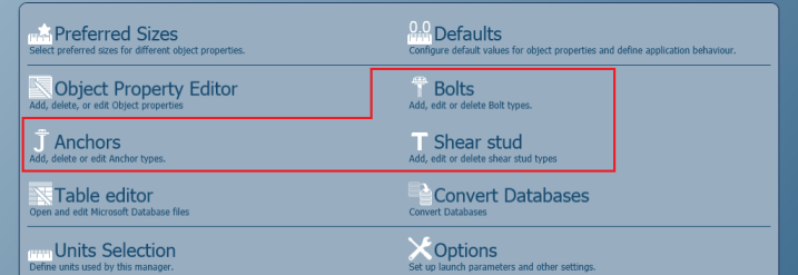

Bolts, anchors and shear studs are transferred from the previous version to the new version through the export/import option in Management Tools, as follows:

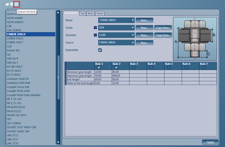

  1. From Autodesk Advance Steel 2016, open the Management Tools: Home Settings (Management Tools):
  2. From the Settings category, select Bolts (or Anchors / Shear studs).
  3. Highlight the bolt (anchor/shear stud) you want to transfer to the new version, and click Export.
  4. Select a path where the exported mdb file containing the bolt (anchor / shear stud) should be saved and click Save.
  5. From Autodesk Advance Steel 2017, open the Management Tools: Home Settings (Management Tools)
  6. Select the desired category: Bolts, Anchors or Shear studs.
  7. Click Import, select the previously exported .mdb file and click Open.
    The Bolt (Anchor/Shear stud) will be imported in Advance Steel 2017 AstorBase database.

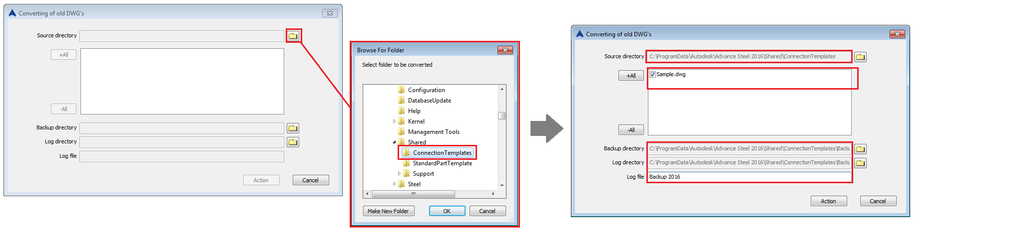

To convert them and make the custom joints from the previous version available in the new version, you need to:
  4. Choose the source directory (e.g. C:\ProgramData\Autodesk\Advance Steel 2016\Shared\ConnectionTemplates), containing the files you want to convert.
