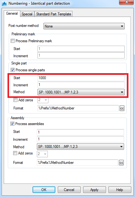

Example: Number single parts and assemblies in one step
On the ribbon, click
(Numbering).
Home tab Documents panel, click
Output tab Part marks panel, click
In the Numbering dialog select Process single parts and define: Start value, Increment value, and Method of numbering.
Select Process assemblies and define the Method of numbering.
Press
F2 to obtain the results in the text window.
The initial numbering gives temporary part marks such as B#internal1001. The final part mark assigns after the Assembly and Single part drawings are created for those elements.
