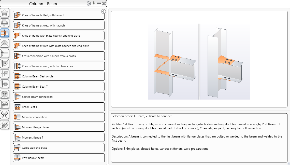

(Connection Vault). Select from the categories of connections in The Connection Vault. Individual element types display appropriate connections.
Group frequently used connections in the Favorites category for quicker access.
