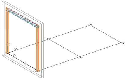

Example: Create a mono-pitch frame
  1. Set a suitable user coordinate system.
  2. On the ribbon, click (Mono-pitch frame).
  3. Define the first base point.
  4. Define the second point.
  5. Define the height of the frame with a right click.
The frame is created and the properties dialog appears. Modify the frame size to suit specific requirements.
