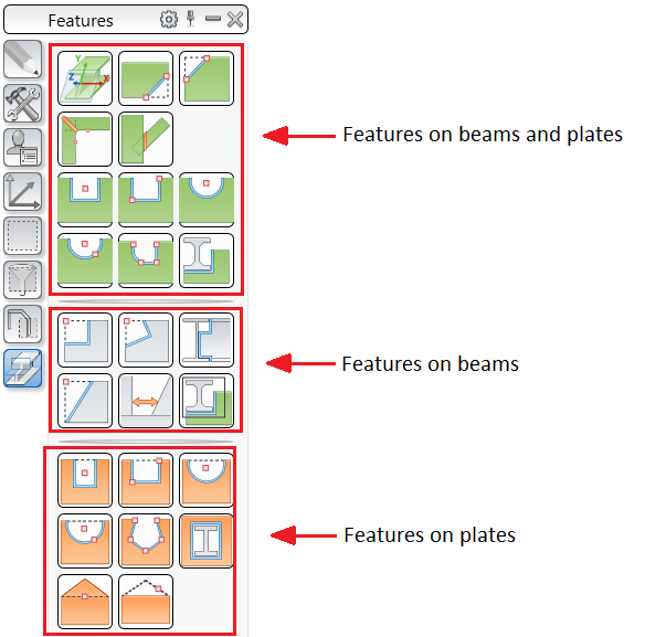

You can cut any beam or plate contour with the Advance Steel processing.
To cut or cope contours, use the tools located on the Features tool palette:
Processings are displayed as green contours in the model. These features are Advance Steel objects and cannot exist independently from an element.
