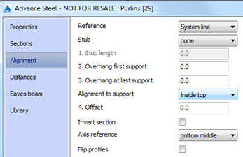

  4. Modify the purlin macro with the right section size and alignment. To position the beam system as floor beams set Alignment to support on Inside top.
