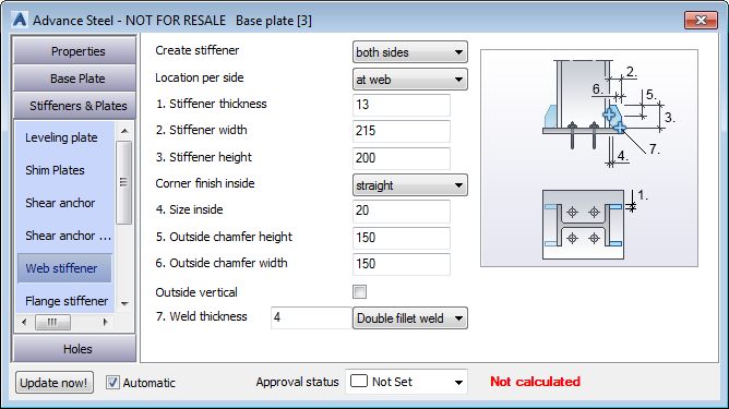

The base plate is created at the end of the column and the properties dialog appears. Modify the baseplate properties to suit specific requirements. Both the column and the plate are welded together.
