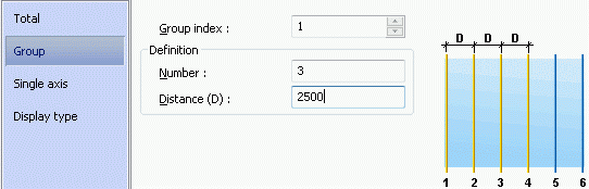

  1. Select the X-axis group.
  2. Right click and select Advance Properties from the context menu. The Axes parallel dialog box appears. All modifications are made here.
To modify the number of axes:
  1. Click the Group tab.
  2. Set the Number to 3. Note that the distance value is automatically calculated. The new value should be 2500.
The model changes dynamically as values are entered or new values are selected, providing instant visual feedback.
