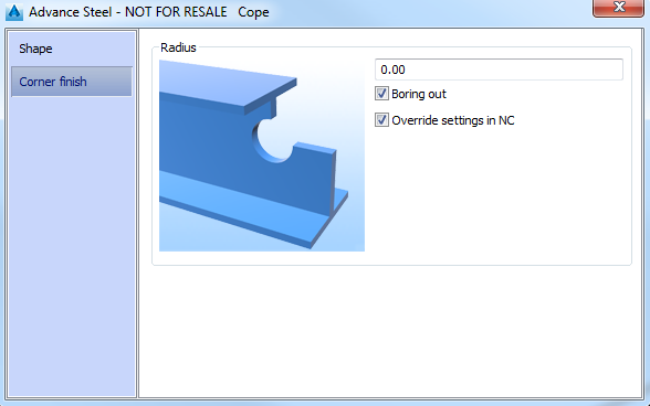

Beam cope Corner finish tab
You can use the parameters on this tab to modify the cope shape.
Radius
Defines the radius at the cope corner.
Boring out
If selected, creates the following cope shape:
Override settings in NC
The NC can override the cope settings only when the cope type is straight.
