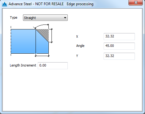

You can use the parameters on this tab to modify the chamfer size.
X
Defines the length of the chamfer along the first selected edge of the plate.
Y
Defines the length of the chamfer along the next edge of the plate.
Length Increment
Defines the increment (grid jump) for modifying the width and the length of the corner processing by grip points.

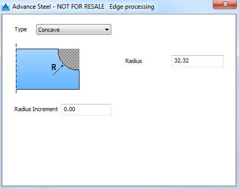

You can use the parameters on this tab to modify the fillet shape. The fillet shape is modified by setting the radius value.
Radius
Defines the radius of the convex or concave fillet.
Radius increment
Defines the increment (grid jump) for modifying the radius length by grip points.
