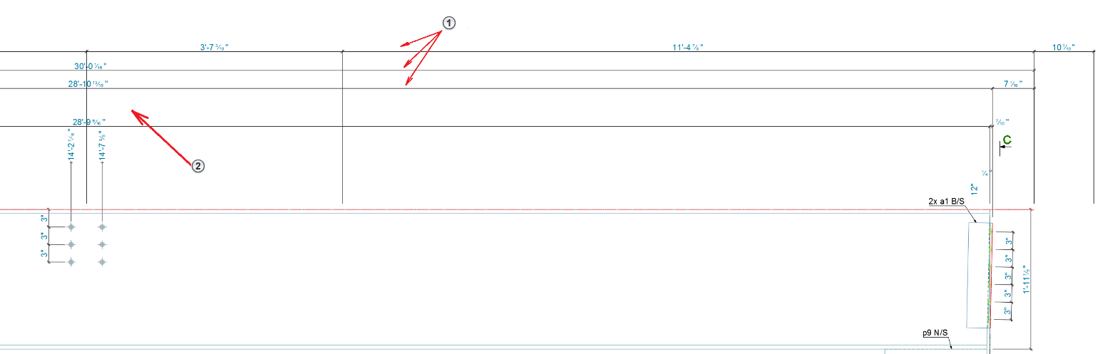

Example: Delete an automatic dimension on a beam assembly drawing, as in the example below:

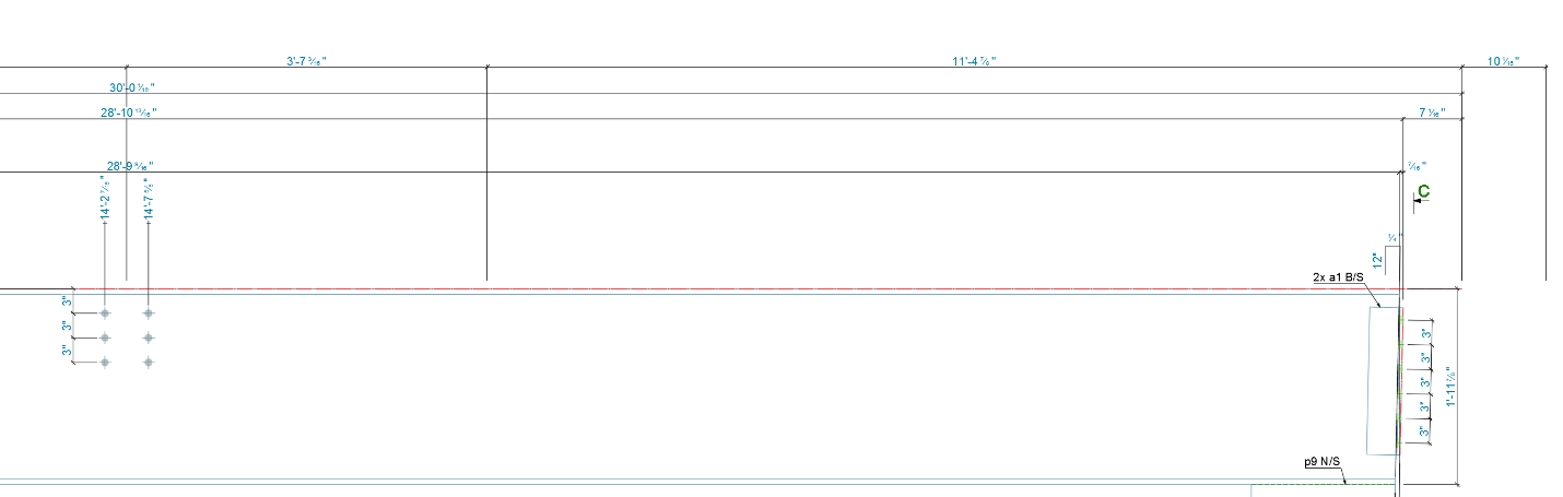

After updating the drawing, the three dimensions chains above the deleted one will rearrange themselves to occupy the gap.

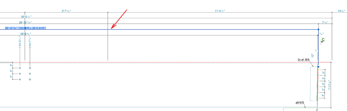

As mentioned before, all automatic Advance Steel dimensions use a set of rules to arrange themselves, and they can also adjust after certain manual modifications, but you can manually adjust their position, case in which the link with the automatic rules is broken for that respective dimension.
- The three manually repositioned dimension chains above the deleted automatic dimension chain.
- The gap left by the deleted automatic dimension chain.

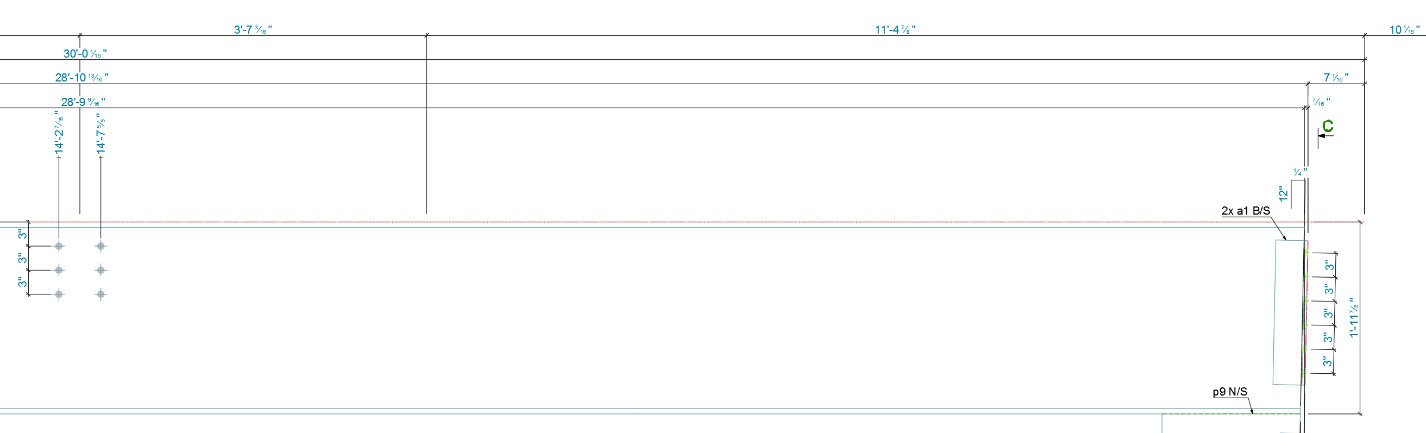

After the update, the manually modified automatic dimensions do not reposition, and the gap is still present. A manual dimension could be created in this gap, and the overlap would not appear as mentioned before.
