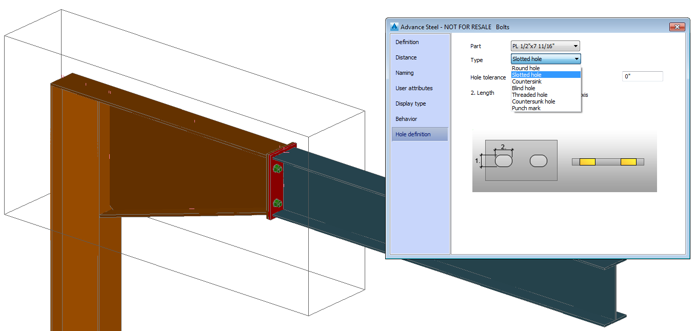

Available hole settings in the Properties window of bolt patterns for bolts created by a joint.
This applies only if, in the joint's Properties window, there are no settings for the bolts in question that address the shape and size of the hole created by the bolt.
By accessing the bolt properties you are able to change the hole type and, depending on that, various hole parameters.
