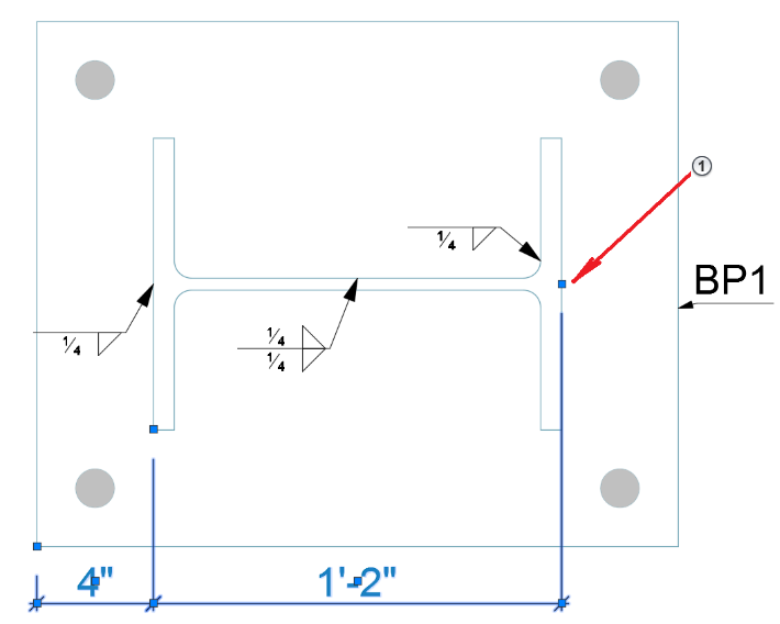

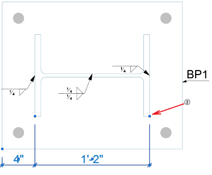

The smart dimension points have a feature that allows them to work on invalid points if a nearby valid point is found along a direction that is perpendicular on the dimension line.
This feature will make the point "jump" during update, extending or shortening the dimension line.
A common case appears, for example, when the mid-point of a beam end is selected instead of the beam corners, for a dimension line along the beam length. Because the mid-point is aligned with the corners of the beam, during update, the point will "jump" to one of the corners.
This behavior has the following characteristics that should be taken into consideration:
| Before Update | After Update |
| Beam flange mid-point | The dimension point jumped to a valid smart dimension |
