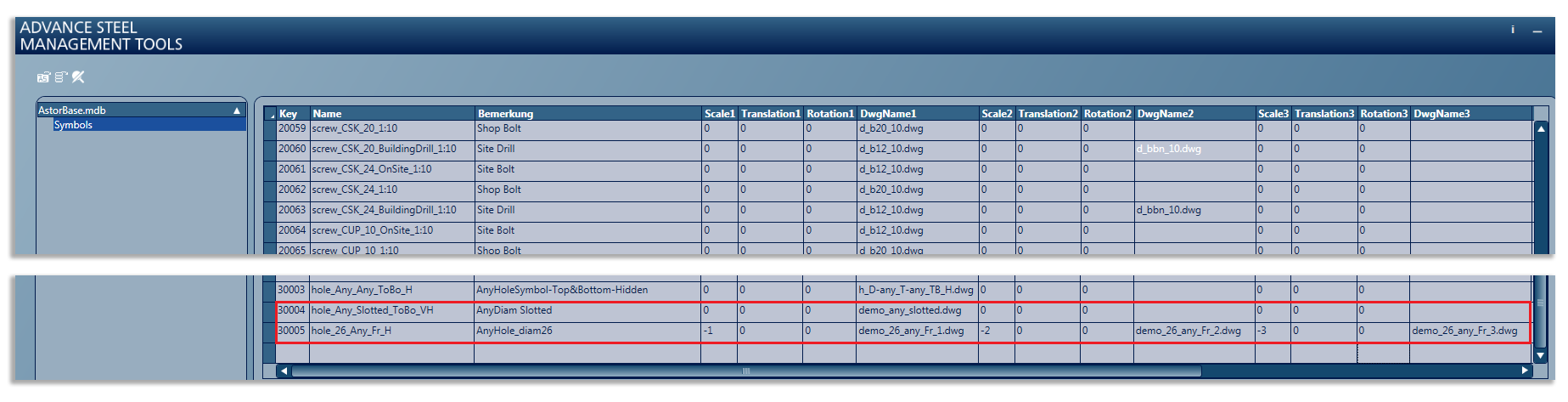

In order to start configuring a hole symbol, you need to access the AstorBase.mdb database Symbols table. To do this:
  1. Open the Management Tools application, from the Home tab Settings panel (Management Tools).
  2. In the Management Tools application, access the Table editor.
  3. In the top left corner of the Table editor, click on the second icon to open a database.
  4. The Open dialog appears. Choose the AstorBase.mdb database file and click Open.
  5. Once the AstorBase.mdb is loaded, expand the heading (by clicking on the arrow next to the database name) and navigate to the Symbols table - alternatively, you can type the word "Symbols" in the Use filter search field to access the table more easily.
  6. In the Symbols table, go to the last filled row and configure a new one after it.

This is how the two example hole symbol configuration lines appear in the Symbols table:
