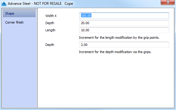

You can use the parameters on this tab to modify the cope size.
Width X
Defines the cope width in the beam direction.
Depth
Defines the cope depth in the beam height direction.
Length
Defines the length increment (grid jump) when modifying the cope length using the grips.
Depth
Defines the length increment (grid jump) when modifying the cope depth using the grips.
