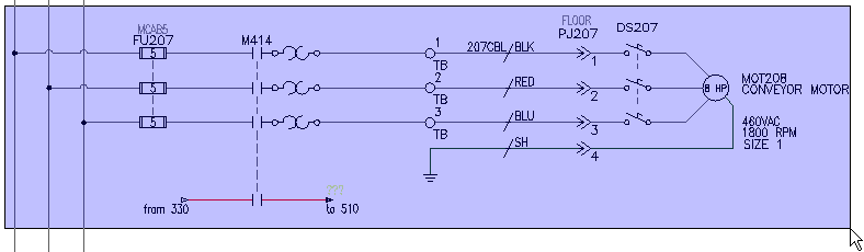

Saving a circuit using WBlock

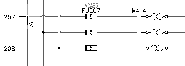

Specify insertion base point:
Select the intersection of the left vertical bus with the upper horizontal wire at line reference 207
Select objects: Window from left to right around the full circuit, right-click
