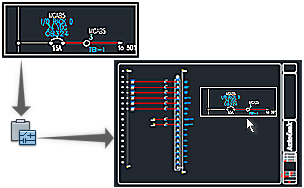

Pastes objects from the circuit clipboard into the current drawing.
Command entry:
AECIRCPASTE
The Paste Circuit command, AECIRCPASTE, inserts objects previously placed on the circuit clipboard by the Cut Circuit or Copy Circuit Clip commands.
After you specify an insertion point, the circuit inserts and the component tags update.
The Circuit Scale dialog box opens where you select options for wires, wire numbers, source arrows, text, and contacts.
