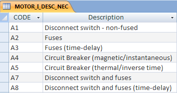

Such an automatic calculation can be accomplished by creating a relationship between the call in the ANNOTATE_LIST field value in the circuit codes sheet of the circuit builder spreadsheet, and the MOTOR_I_* tables in the electrical standards database.
Here is how it is defined:
Here is an example for a disconnect switch entry:
(c:ace_cb_anno2 nil “A1” “RATING1” 0 nil)
In this example, “A1” is the code to match in the MOTOR_I_DESC table (for “Disconnect switch non-fused”), and “RATING1” is the attribute on the inserted disconnect switch symbol to receive the final calculated amp value.

When a component has multiple calculated values such as a disconnect switch with fuses, the two RATING attributes for the component are semicolon delimited, as shown in this example:
(c:ace_cb_anno2 nil “A7” “RATING1;RATING2” nil 0)
The MOTOR_I_MAP table contains corresponding semicolon delimited values in the RATING column.
