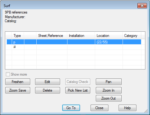

Surf to the related schematic component
. Find
Select tag for “Surfer” trace (or <Enter> to type it): Select 9PB

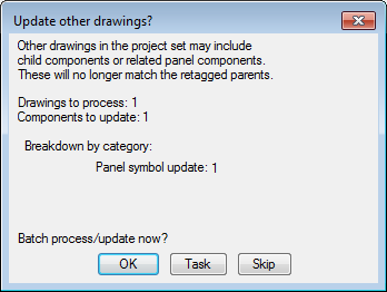

The Update Other Drawings dialog box displays. This dialog alerts that other drawings in the project set include child components or related panel components.
. Find
