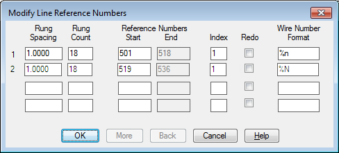

Edit the first rung reference number to resequence a ladder.

Resequence ladder line reference numbers

The Modify Line Reference Numbers dialog box displays a list of ladders in the drawing.
The reference numbers update along each ladder.
