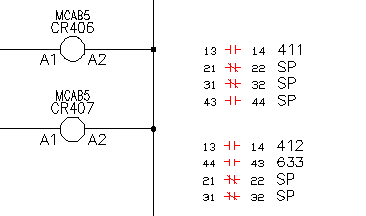

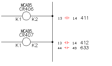

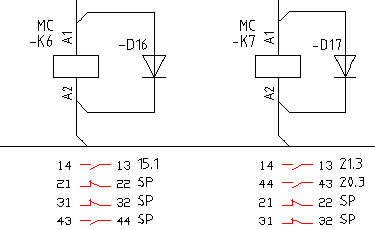

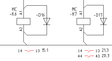

Displays the cross-reference format using the JIC-style or IEC-style graphical font. The setting is applied to the graphical font regardless of the tagging mode assigned in the project properties. This setting is taken from drawing properties if there are no cross-reference overrides specified on the inserted component.
![]() JIC |
![]() IEC |
The following example displays cross-referencing next to the symbol in the graphic font format while the unused children (contacts) are displayed as separate references. The Fill Reference With value is “SP.”
![]() JIC |
![]() IEC |

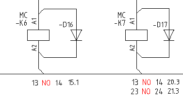

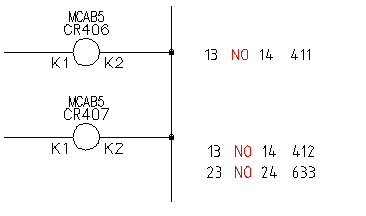

Displays the cross-reference format using cross-referencing type values (NO, NC, NONC).
![]() JIC |
![]() IEC |
