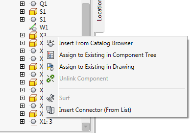

  1. Click Project tabProject Tools panelManager. Find
  2. In the Project Manager, click the Location View tab.
  3. In the Location View tab, right-click the Inventor part and click Insert Connector (From List).
    Note: The Inventor part needs to be either a connector category component, or an uncategorized component; otherwise the option is not enabled.
